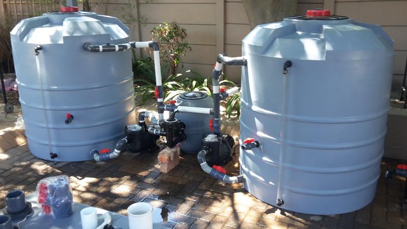

    Hi Guys.
    Well done to all the guys out there who have setup their own water treatment plants. I am glad I could be of assistance. The response to our adds were phenomenal and we want to thank all our new clients for their support. Just showing you the system that we install at our clients with great results.
    Regards
    THEO
    (theoventer@hotmail.com)
