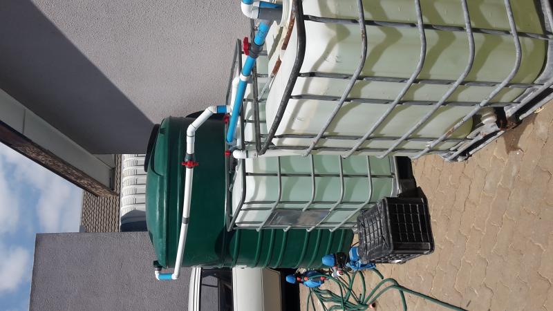

            I have been reading up on ground water purification for the past two years. I wanted a system which was cheap and effective. I wanted to put my red iron filled well point water through a system where I can use it in my house and also drink it.
            I did the following.
            I got two thousand litre flow bins and one two and a half thousand storage tank. On the first flow bin I installed a normal swimming pool sand filter. I then pump my well point water (very red to a point where it stain the walls) into the flow bin and filter it through the swimming pool sand filter. I add half a cup Chlorine to the water and pump it for about four hours. The chlorine oxidises with the iron and the iron is then catched in the sand filter which I backwash out. After four hours the red water becomes sparkling clean like a normal swimming pool.
            When the water is sparkling clean I pump it over to the next flow bin. The only problem then is that the Chlorine and chloramine is very high. I then add Potassium Metabisulfite to the water which takes out both chlorine and chloramine from the water. This chemical works immediately with immediate effect. The potassium
            metabisulphite reduces the PH to about 5.7. I then add soda ash which takes my PH to about 7.1. This water is now iron free with no bacteria. Colourless, odourless, germ free drinking water.
            Metabisulfite is what the use in wine, cooldrinks and lots of foodstuffs. Metabisulfite is also an anti oxidant and a preservative. I have been using my system for quite some time with great success. I produce about 4000 lt of clean drinking water which I then pump into my storage tank for home use.
            Cost involve in this mini water purifying system is very minimal.

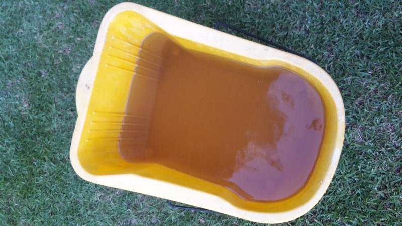

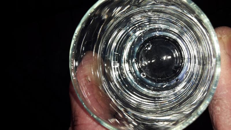

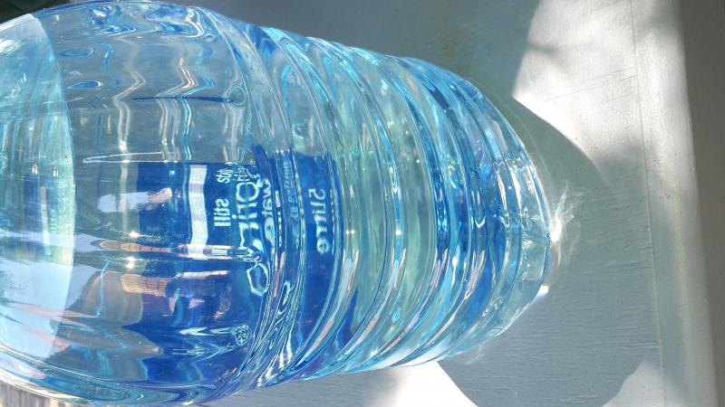

ID:	265434Hi all you guys.
                        Here are some photos of my water, before and after and I will try and answer all your questions as I go along. Best to E-mail me at theoventer@Hotmail.com.
                        As you can see on the photos there are no expensive bought filters that does not work. My little pool is cristal clear and my wellpoint water in the yellow bucket is drinkable.
                        Any other questions will be answered by E-mail
