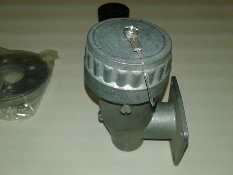

    [Opinion] Stove couplers
    I have never seen n stove couplers installed according to regs. The stove repair i done this week had 2 x 2.5mm surfix connected to stove from isolator.Click image for larger version
    SANS 10142-1, Edition 2, requires that free-standing cooking appliances be connected via a stove coupler and that a switch-disconnector must be installed.

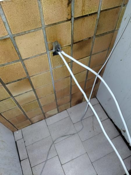

    This client had a valid coc
