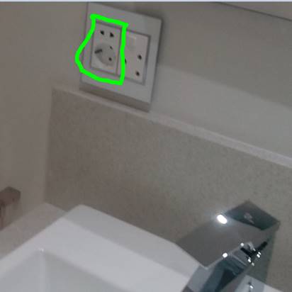

                      For those not familiar with the Schuko outlet -
Name:	schuko outlet.jpg
                        Is that your bathroom Dave? As the estate agents say...location, location, location and that's certainly a lovely location for that socket, I can only assume there's a nice big 20Amp isolating transformer behind it. Nice to see it covers all bases and even the illegal ones with equal aplomb, there's even a cunning little ledge under it giving you somewhere to balance your hairdryer above the full basin. Certainly goes above and beyond, full marks from me.
                          • 22807
                          It was actually the query about the location we posed to the ECA technical advisory staff that "induced" the point about the Schuko socket & outlet ban.
                            • 1473
                            Hi Dave
                            Do you still have the answer handy with regards to the location of the socket and proximity of the basin ( let's forget about the illegal schuko)
                            My understanding would be if the bath or shower basin is far enough away from the socket outlet , being 600mm ( Zone 2) , then the socket outlet would be allowed above the basin/tap.
                            Socket outlets on Earth leakage unit are allowed in zone 3
                            There are no zones around a hand basin and tap the way I read the regulations.
                              • 22807
                              Correct. Not in SA anyway.
                              Madness, I reckon.
