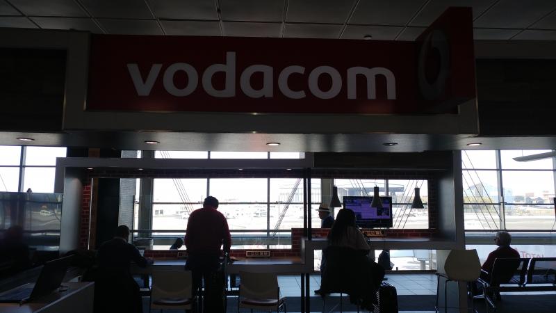

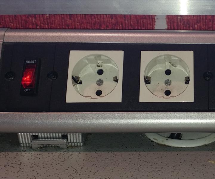

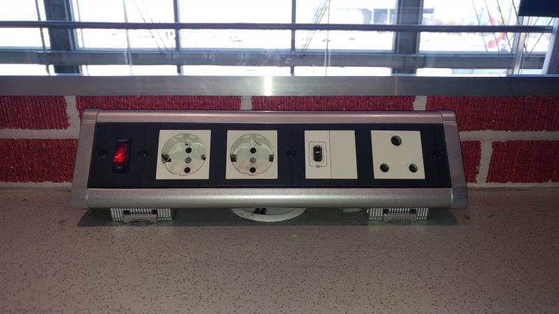

        And then you get the ones installed in the Vodacom charging kiosk in the domestic departure area at O.R. Tambo International Airport.

        As you say, apparently the issue of concern is the exposed earth contact points. It did make me wonder about the wisdom of allowing bare copper wiring and strapping for earthing and bonding...
