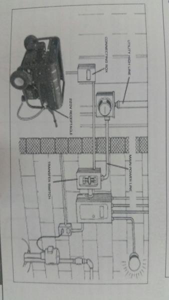

          Something to note, not all small generators cannot be connected to a house. I indicated to a customer today that it was not wise to connect a small generator to a house. He set the record straight with documentation and a diagram showing how to do it.
            Diagrams sent to me today, indicating how to connect these generators as standby units.
Name:	grip diagram.jpg
ID:	264365Click image for larger version
ID:	264366Click image for larger version
Name:	grip generator.jpg
              Still a bit concerned about how you can connect a 7.5 kva generator using a 15 amp socket outlet.
              I wonder if these generators are SABS approved or have documentation to backup.

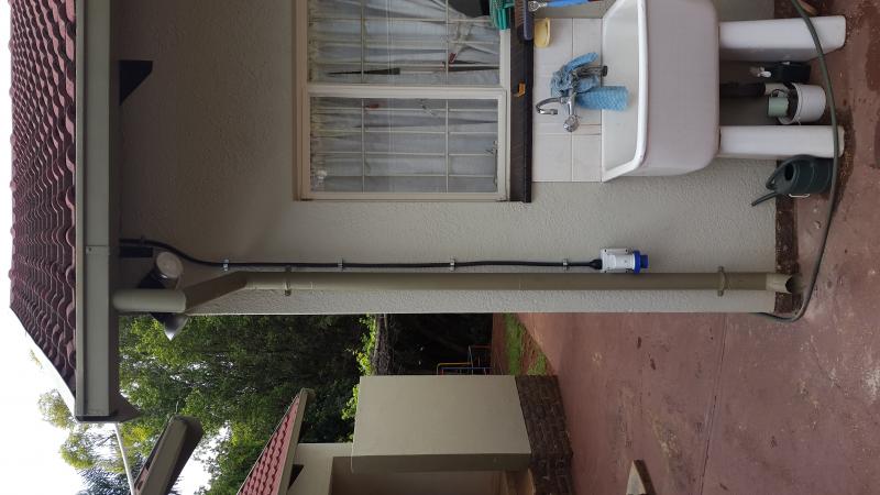

                You can use one of these 32A CEE sockets

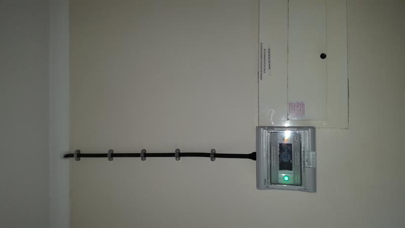

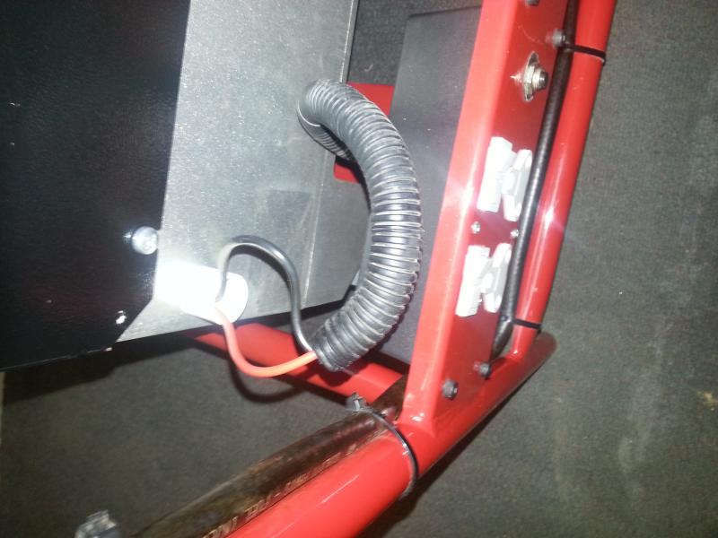

                            #28
ID:	264372Click image for larger version
                              #29
                              I have something similar to the pics, except that my in coming plug is close to the switch over board. So I have a long extension from the genny.

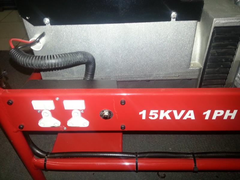

                                #30
Name:	15kva honda.jpg
ID:	264375Click image for larger version
Name:	15kva honda 16a plug.jpg
                                Same issue, 15kva Honda, cannot add or change to the gennie wiring otherwise guarantee is gone.
