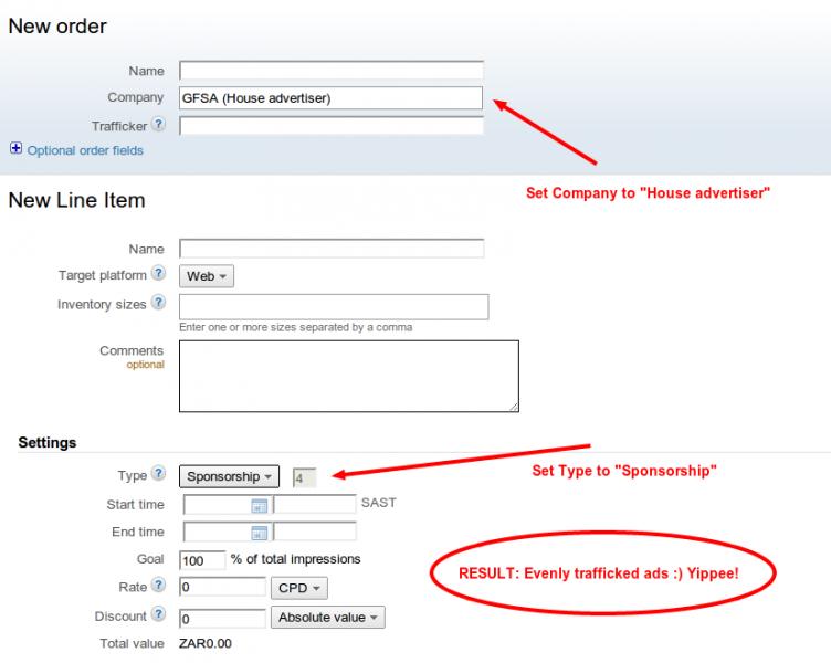

                Basically they recommend setting all the ads as "Sponsorship" priority. That is apparently the highest priority and if they're all set the same, they'll rotate evenly. Our issue was that we had 1 paying client on "Sponsorship" and our own in-house ad on "House". The "House" ads are the lowest priority so they never showed until I reduced the percentage of impressions for the client's ad to 50%.
                So now the question is: Do I set up a dummy company for our in-house ads so we can have our ads competing on even footing with our client's or do I move them all to in-house, with the same effect. I'm thinking of doing the former as it (I believe) makes it possible for us to easily share the reports with our clients - something which I think is important.
                The other option, which I haven't investigated yet, is to simply set our own ads as priority "Sponsorship". I'm not sure if that's possible: To have a house ad (under the house company) and still have a non-house priority. THAT would win first prize. Time for me to check if it's possible!

                  Oh yippee, it's possible

                    When it comes to DFP, I think almost anything is possible
