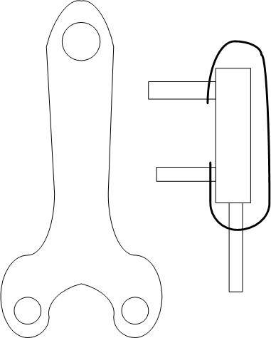

    There are plugs available which have a small handle on the back of them to facilitate easier removal when unplugging. I've also seen a wrap-around plastic thingy (can't really describe it better) which fits over the plug pins and forms a handle behind the plug. I think one of the charity organisations like the Lions was selling them. I'll hunt for more info.

    Can't find a picture but it kinda looks like this.
    Sorry if its not very clear, it's late and it's not easy to draw. On the left is the thingy flat as it arrives in the packet. On the right is how it wraps around a plug to form a handle. Maybe someone else can remember the name of it.
