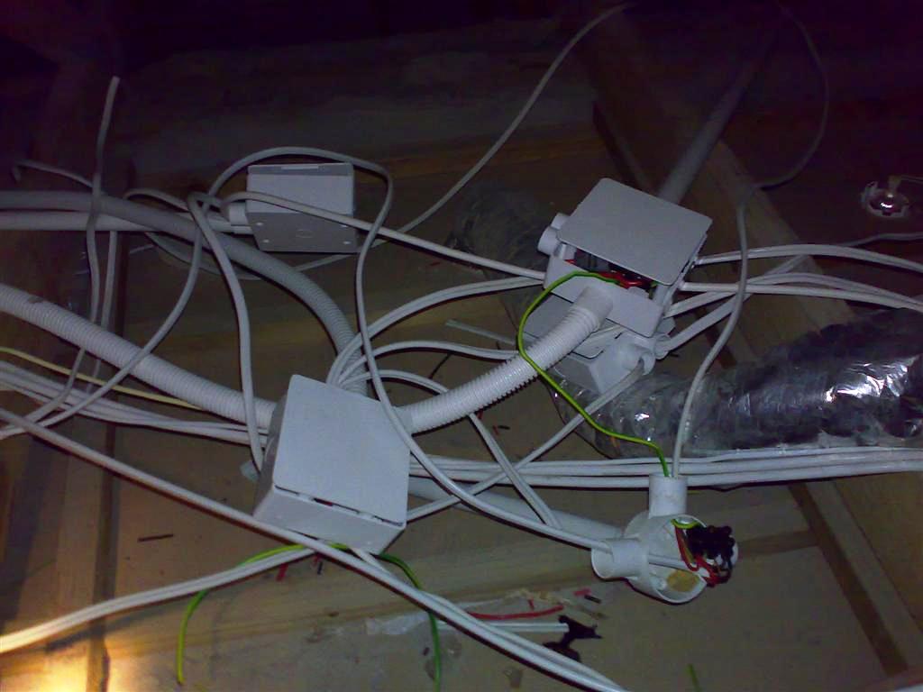

    this is a picture of a typical electrical installation...if you have had a house built in the last 5-10 years this is what you can expect to see in your roof...low cost house has a whole new meaning...you just pay millions for it now.

    the way i see it is if i spend 2.5 million rand on a house i expect to get quality...meaning a quality built house...quality plumbing and electrical job...in fact everything should be of a good standard.
    if you buy a mercedes you get a good quality motor vehicle...it probably wont have cheap crap tyres...why expect anything less for the all the services in your house...considering your house will be one of the biggest investment you will ever make.
