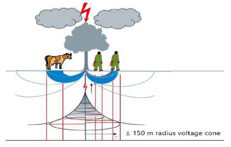

    I am yet to see an earth mat installed for a solar installation. That is why specialized tasks should be carried out by people who are specialists in that field, not by a bunch of clowns who think randomly knocking in a bunch of earth spikes around a property is going to cut it.
    The earthing on for instance a tower with an earth mat in the ground will take the ionization that forms in the air down to earth using the earth mat to dissipate the voltage
    At the point in time the potential difference in the earth will lift closest to the earth mat and become less further away - Animals legs are 1,5m apart and therefore the potential difference can increase between the legs briefly and sufficiently to electrocute them - The increase in potential difference is dependent on the proximity on the lightening
    Is the reason you should shuffle if walking outside in a thunderstorm and the reason why the 2 guys carrying an extension ladder of 5m in a thunderstorm took a big hit - It was not a direct strike but just that they were in close enough proximity of where the lightening happened to hit the ground and the distance between them joined with an aluminum ladder increased potential difference across them .
    The potential difference of the ground depending on the size of the strike can be in a conical effect over a distance of 2KM - the attached oic gives an idea
    Attachment 8692

    It makes sense Shadyshaun but what if the authorities requires an earth spike?

    The site assessment and design will determine the specifics. Electricians are not design engineers, nor are they lightning specialists and therefore should not be offering solutions, which do not fall within their scope of expertise. It would appear (reading comments on social media) that many electricians feel that one size fits all and every application is exactly the same, you will even be rewarded with certification once you have completed a certain number of installations.
    If the design criteria specifies an earth spike, it should be installed.
    Would an earth wire fry, it would depend on the intensity of the strike. Without testing the resistance of the earth wire, you would never know the impact of the strike. It may appear to be ok, however in some cases the wire could reach such extreme temperatures that it would render the wire pretty useless.
    If you have been in the electrical industry for a while, you would have noticed wires which are no longer "shiny bright copper" , they are not as flexible and turn a blue/black colour, they should be replaced.
