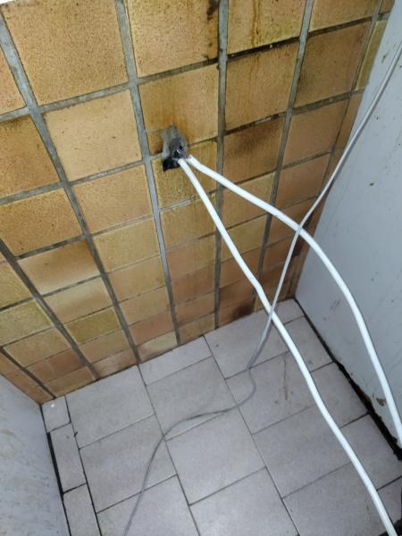

    I have never seen n stove couplers installed according to regs. The stove repair i done this week had 2 x 2.5mm surfix connected to stove from isolator.Click image for larger version.
    SANS 10142-1, Edition 2, requires that free-standing cooking appliances be connected via a stove coupler and that a switch-disconnector must be installed.

    This client had a valid coc

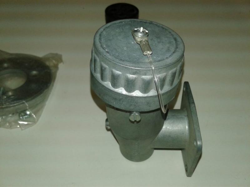

    Jo'burg - went 7 suppliers - None could get a stove coupler for me and all looked at me like I was mad.

    Quote Originally Posted by Alfred M View Post
    Stoves do not need to be connected via a stove coupler anymore. They can be wired directly to the isolator through a flexible arrangement.
    I remove the stove connector on the wall.
    Rewire from the isolator with 4mm house wire leaving 2 metres of slack out the wall.
    Fit a dome lid where the plug was and use spraque ( flexible conduit ) between the dome lid and the stove.

    Quote Originally Posted by skatingsparks View Post
    I will ask the question form a supplier we use but was under the impression that it is no longer a problem as somebody bought the molds from procast and continued manufacturing
    The old type cooker plug is still readily available along with the rings etc
    Socket complete with plug top comes out at around R1K
