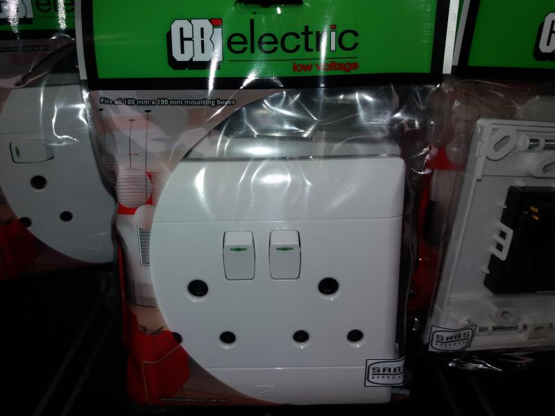

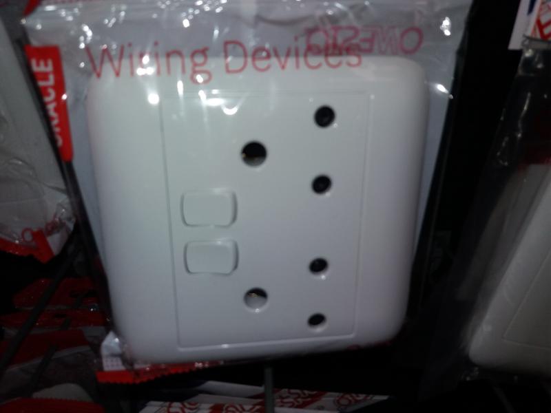

    What do the above plugs have in common ?
    There are many more, but I am limited to 6 photo's per thread.
    Peace out .. Derek

    The covers are all plastic and attach with clips...and of course they are not the new SA standard (I think.....)

    My kind of plugs ... non have the silly za socket

    All have a switch for each point and also it appears that all bar the one have shutters? Interested to know more though
    Also all have plastic packaging so perhaps green peace a bit pissed off for single use plastic.

    Installing any one of them since January 2018 has been illegal. ( See SANS 10142-1 Reg 6.15.1.1.1.c )
    The question is .... Why, after almost 4 years of the reg taking effect, are they still being displayed and offered for sale by all the electrical
    wholesalers if it is not legal to use them ?
    Peace out ... Derek.

    6.15.1.1.1.c Effective from January 2018 all socket outlet points for new electrical installations shall include at least one socket outlet complying with the dimensions of 164-2. Socket outlet points may also include socket outlets complying with the dimentions of SANS 164-1.
    Remember, if you replace a burn't socket outlet with a new one, that point is considered a new installation and the reg therefore
    applies.
    There is no need to stock plugs with only 164-1 sockets. They, according to the regs, should not be used.
    Peace out ... Derek
    PS. Had I worded this reg, it would have read " effective from January 2018, every socket outlet point for new installations shall include a socket outlet with the dimensions of SANS 164-2".
