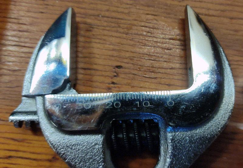

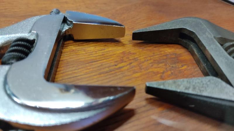

    The top picture shows both the Facom spanner and the Monument spanner side by side, the tape measure is just there for scale.
    Starting with the Facom spanner, it's very short (about half the length of a normal shifting spanner) which means it doesn't take much space in the tool bag and it's relatively light compared to normal shifting spanners. It's very well built and engineered which means it doesn't twist or slip even under high force and it has a corrosion resistant finish. The jaws are thinner than a normal shifting spanner which means it can get onto nuts which are very close together. Finally and most importantly it can get onto a nut that's 45mm across the flats which is enormous.
    The Monument spanner has similar attributes, it's also well engineered with very little play and float in the jaws. It's also very short and it can accomodate a very large nut that's 39mm across the flats. It has thinner jaws than the Facom version and it's jaws are also tapered thinner towards the tips which means it will sometimes access an awkward nut that the Facom spanner can't.
    I'd say both spanners are superb and neither is better than the other. It's a shame the Facom jaws aren't a little thinner and it's a shame the Monument spanner isn't chromed because it does get light corrosion after time. Both spanners score an individual 9 out of 10 which is high praise indeed. As a pair they compliment each other perfectly and as a pair I'd score them 9.5 out of 10.

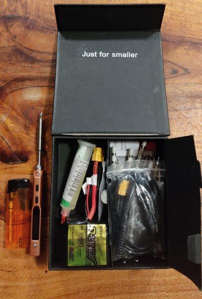

    After several decades of disappointment everything changed when I came across this little beauty;
    It's a battery operated portable soldering iron that will run on any DC supply between 12 and 24 volts. This alone is a game changer, it means you can run it on your bench supply if you do board repairs or you can use a small lithium ion battery like I have in the picture. It will also run direct from a car battery or the car cigarette lighter socket if you're doing automotive work and you can even get or make an adaptor to run it from an 18 volt powertool battery in which case you won't need to carry a special battery for it.

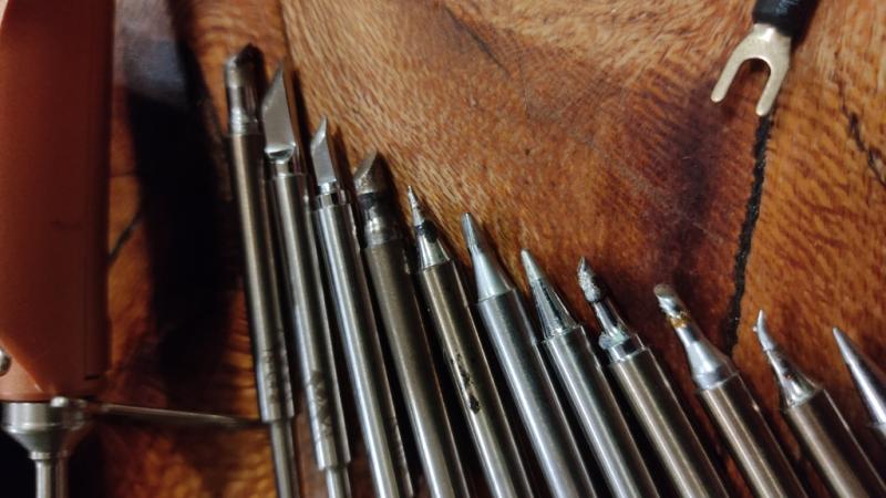

    The range of tips available is pretty impressive with various sizes of conical, chisel, beveled and pointed tips available. I carry the iron in the box it came supplied with along with the battery, some flux, a tip cleaner, various sizes of resin cored solder and the 3 tips I most commonly use. It's portable, light and I don't carry the charger because it operates for at least an hour on a single charge. It also has an idle function when you don't use it for a minute or two and its built in gyroscope sensor automatically reheats it to set temperature as soon as you pick it up again. It's also ESD compliant and it comes with an ESD cable you can connect to your mat to avoid static damage to components being soldered.
