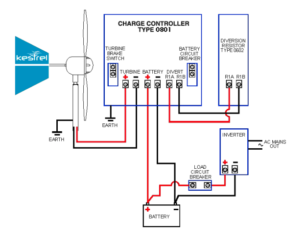

    Perhaps some clarification of my contribution is required.
    It needed to be said that normal overcurrent protection and safety needed to be included.
    Also that a controller is required, wired as per the manufacturers requirement.
    In the case of Kestrel Turbines, which we installed, the 3phase AC was converted to DC in the turbine head.
    This went through a PWM controller to charge the batteries, however the effective path was directly from the turbine DC to the batteries.
    The "direct" path to the batteries make the turbine a current source device. This current is used to either charge the batteries and/or power the load.
    The primary role of the PWM controller is to send excess current to the divert resistor if the batteries are fully charged and the normal load is less than what the turbine is generating.
    It is important to keep the turbine under load when in high wind conditions as this restricts speed and possible damage to the turbine.
    In the case of the post from Riaan a Tesup turbine and controller are installed.
    The turbine has a 3 wire AC output which the controller converts to DC, but after that the process is the same as the Kestrel with a PWM controller using the dump/divert resistor that is integrated.
    The charge controller needs to be connected to a battery.
    I have never seen or read of a buck/boost MPPT controller for small wind turbines and could not see such on the sustainable website. Some more information on this would be useful.
