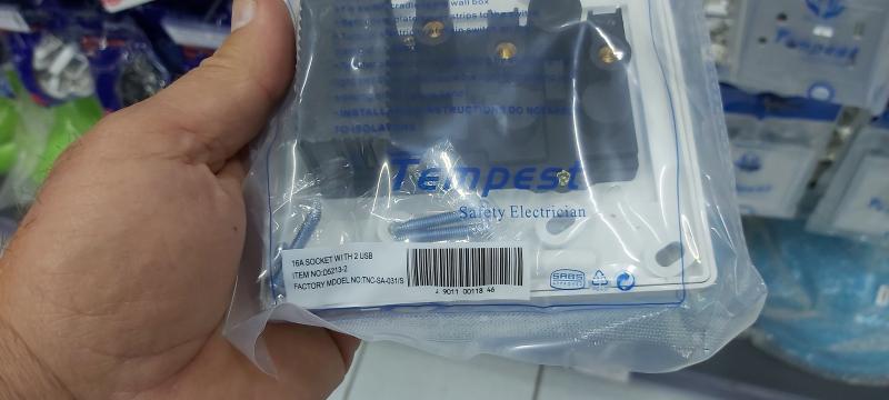

    I saw these on display in a Chinese shop at K90 Center, Boksburg. Note the SABS mark as well as the 20 year guarantee.Click image for larger version.

    Quote Originally Posted by Leecatt View Post

    Chinglish - Guaranty?
    The art of copying
