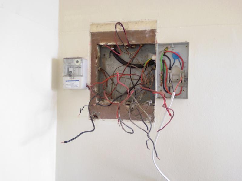

    Even where a seperate earth is supplied, it is still bridged with the neutral in the prepaid meter. Mine included.
    Supply Authority will NOT install the prepaid meter if that special copper link that is supplied with the meter bases is not in place between the earth and neutral on the meter base.
    Peace out ... Derek.
    You will notice that even although there is an incoming earth, if you look closely you will see a bare copper bridge between the earth and neutral.
    That's how it's done here.
