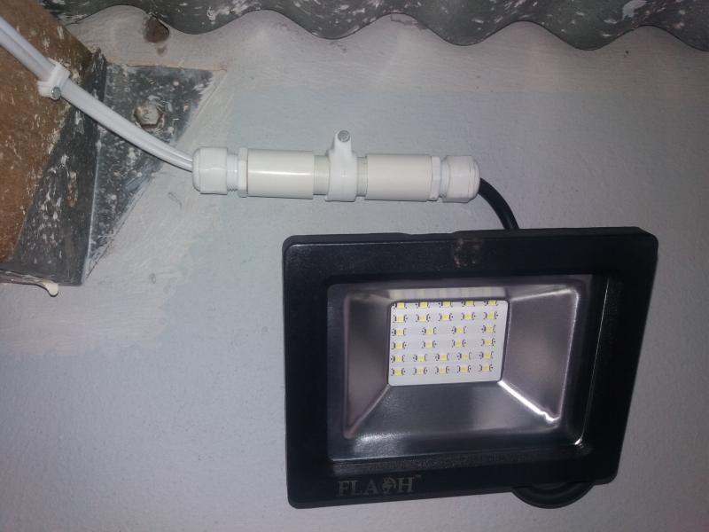

    What would you guys say about this connections ? Crimped together then heat-shrink over it. I want to say that if they just added another sleeve over it all to cover the single cores it would be ok ? Or what are your guys thoughts. Wanting to know as I now have to add extra down-lighters thats the same to this installation.
    Apr 2010
    planet earth
    3,943
    153
    The person who i sue to do my COC's on occassion would fail it for 2 reason ... 1 no connector on the earth and the other exposed wiring.
    I take a piece of 25 mm PVC pipe glue pushin glands on either side and bingo you have a joint protected ... or just use a coupling with 2 pushin glands.
    I use this method on flood light with those silly short 100 mm tails ...like radiant sells at ARB for around R60.

    Forgot about the earth wire. Would also just crimp it with a ferrule.

    For the first picture a three way pvc box with three push in glands. Hopefully there is enough cable on the light fitting to reach inside of the box. That should satisfy 6.3.7 & 6.4.3 of the regulations.

    Thanks for the tip, Ian. Tried your idea today. Simple, yet brilliant. Will use it for downlights as well in future.

    How is this legal?

    Actually a very good idea DOES THE TWO PLUGS TURN OUT FROM EACH OTHER?
    the lights cable is very short everybody is complain about it.

    Quote Originally Posted by Lindley View Post
    Have a closer look at what it is
