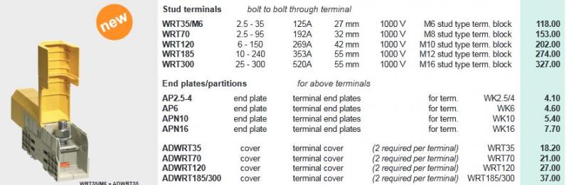

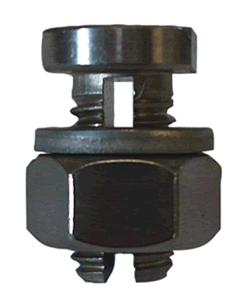

    Just crimping with a ferrule is fine if the cable is glanded into an enclosure and joint is inside. Line tap connectors or DIN mount stud terminals would be another couple of options that have the advantage of being servicable in future. If the cable is trailing and you're jointing the cable with ferrules you should use a resin joint to give strain relief.
    DIN Mount Stud Terminals

    Line Tap Connector
