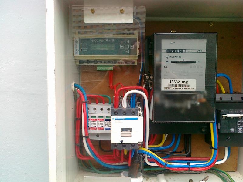

    Pretty much what we have been doing since around 2008...the only issue is in areas were the voltage is so unstable that it drops below 180 or increases above 260 ...which is pretty much what becoming the norm ...add in load shedding and you got yourself a real problem...you wouldnt need a flasher unit for your lights

    Hi Ians
    I noticed that the earth and neutral are swapped around on the surge arrestor - I see that the earth is in the "PE"terminal - cant make out anything on the bottom terminal
    To me this means that any surge that is being clamped will be put to the neutral and that the neutral will be spiking.
    Came across it before and it was the cause of intermittent ELU tripping

    I cant really read the instruction, but normally on the ones that we install the earth would be at the bottom and the neutral at the top...
    i suppose a different manufacturer will have a different setup

    We wire them as per the supplier specs ...it depends on the type and manufacturer :
    https://surgeprotection.co.za/produc...boards-3-phase
    http://www.surgetek.co.za/diagrams.php
