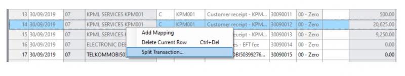

    I use Sage and am not a bookkeeper, so this is probably not very professional but it’s what I do for our sports club bar sales.
    Created a “Liquor sales” customer and “Yoco charges” in expense accounts.
    Create invoices from the sales report on Yoco portal (all items are listed in “Products”)
    Great help with stock control.
    Allocate the cash received to the invoice.
    When the Yoco payment is imported via bank refresh, I click on the “split” and allocate.
    Liquor sales 1,296.00 (change from R1,252.05)
    Yoco charges -R43.95

    Hello Keith.
    You may not be a bookkeeper, but you just absolutely blew my mind!! This is a feature in bank manager I never knew about. Thank you for showing me. Below is a screen print of this option (just right click on any line and you will see it).
Name:	Split transaction in Bank manager.jpg
    This option seems manageable in a low transaction environment. But how do you manage and reconcile it if you have say 50 YOCO sales a day? Or are you capturing your individual sales through a POS / cash register and then bringing in 1 sale a day into Pastel?
    My second question is how do you know your Liquor sales amounted to a gross amount of R1,296 when processing in bank manager? Do you see this in the debtors view balances, write it down and then go and do the transaction in bank manager?
    Thanks again for sharing Keith. Neat feature!
    Looking forward to hearing from you.
    All the best!
    Alec Candiotes (CA) SA

    Hi Alec
    Both your presumptions are correct.
    Invoicing is actually quite simple, one may stock of 100 products but sales for the day may only be for various amount of 20 products which is all listed in Yoco’s portal.
    I have 2 monitors, one with Sage open and the other with the Yoco portal open.
