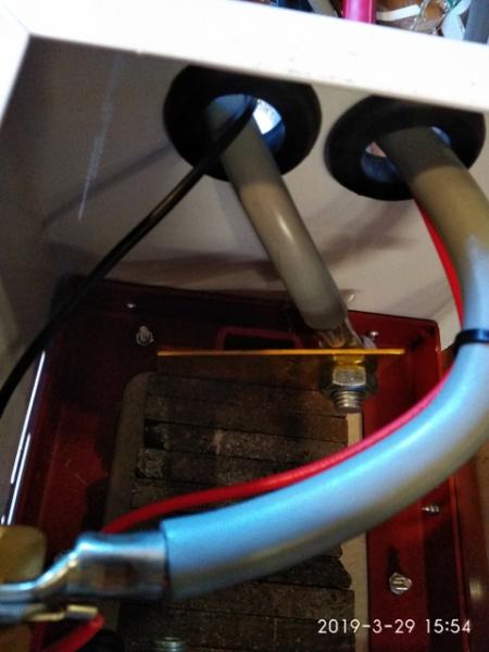

    You can see the negative wire bolted to the resistor brass end plate in this photo.
    Each battery clamp has a separate thin wire running to it as well as the thick 35mm². The other end of these wires go directly to the voltmeter on the front of the tester. I like this a lot, it gives much better accuracy for the voltage reading and this accuracy is exactly where it's needed. It's an elegant touch that indicates care in the design.

    The general build quality of the enclosure and internal chassis is great. The enclosure is thick steel sheet that won't bend or distort even if/when some idiot inevitably uses it as a step ladder on site. It's nicely manufactured, finished and powder coated and the handle is solid and well fixed. The only problem I found is that the holes for the cover screws were all slightly oversized.... either that or the screws themselves were undersized. Either way the cover screws don't tighten properly, they just perpetually spin even under very low tightening torque.
    The beauty of this tester is it's simplicity, there's only a handful of components and nothing really to go wrong if it's used as intended. Inside the tester is basically just a shunt and a resistor.
    The shunt is just a very low resistance that means the full test current doesn't flow the the analogue Ammeter. Usually shunts are precisely manufactured and calibrated things that cost a fortune but in this particular application it doesn't need to be accurate because it's on the current measuring circuit, not the Volt measuring side. With this type of test it doesn't need any degree of accuracy with the current being drawn, even a 10% discrepency will have very little effect on the outcome of the test. The designer was obviously aware of this and shrewdly didn't add unnecessarily to the manufacture cost by specifying a high tolerance device where it's not needed.
    The brass bolt or threaded rod does the job admirably I'm sure and would even allow for some calibration adjustment by moving the nuts. The right angled brackets that hold the shunt are slightly bent and I'm guessing this was intentional and done during final calibration.
    The resistor is equally interesting, it's what's known as a carbon pile rheostat or at least that's what it was called 40 years ago when I last encountered one. It's basically a stack of carbon blocks with a connection at each end and some kind of mechanical way of compressing them together. The tighter you squish them together the better contact they make with each other therefore the lower the resistance gets.

    Because of the high currents involved they've actually doubled up and used two piles of carbon blocks back to back in parallel so it's actually two carbon pile resistors that act together as one component. The carbon blocks are slightly dog-eared but this resistor is a psychopathic thug compared to most resistors and a few chipped corners isn't going to bother it in the slightest.
    Compressing the carbon piles is achieved by turning the steam-punk looking handle on the right hand side of the tester until the correct test current is achieved. The handle is pretty big and beefy, maybe a little too big and beefy. Only a small amount of compression on the carbon piles gives a surprisingly large amount of current increase and it will be very easy to overshoot the desired test current and possibly even crack/crush the carbon blocks if you're a bit heavy handed whilst winding the handle. It might have been a more idiot-proof design and less prone to unintentional damage if there was a spring incorporated somewhere in the adjuster to dampen the compression force and make it less likely for over tightening to occur.
    Big currents go hand in hand with big heat and when you're running 600A through any resistor it's going to get hot. This means heat management and mitigating the effects of the heat would play a big part in the design of any tester like this. Containing the heat in zones where it's appropriate and managing it quickly by conduction sinking it into a larger area and getting rid of it efficiently by good ventilation are essential. Both aspects are well covered here by a combination of a thick metal mounting chassis around the resistor, heat shield/deflector above the resistor and a massive amount of louvred ventilation on every surface except one on the outer case.
