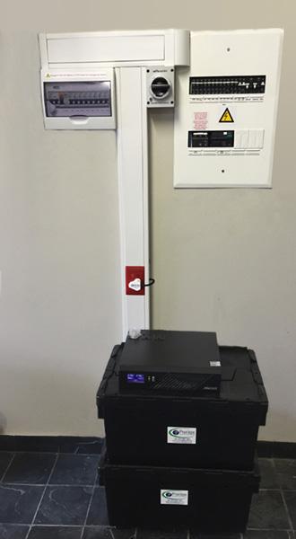

    I have done a similar installation where a sub DB was installed with it's own single phase E/leakage
Name:	installation complete copy double web.jpg

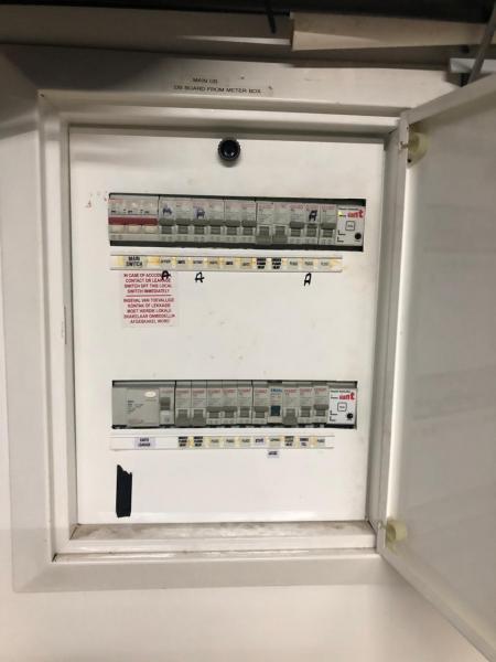

    However it was relatively easy to move the circuits over due to the flush design of the DB.
    On this installation the DB is raised & would prove difficult to move the circuits.
    I am also trying to minimise costs.
