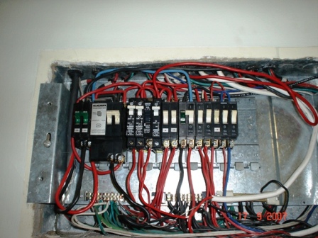

    to the man on the street you wont even see a problem here...the 30 amp circuit breaker has been bypassed and it is now tripping a 50 amp circuit breaker upstream...by the way this DB is in the frail care centre of the old age home.
Name:	bypassed circuit breaker.JPG

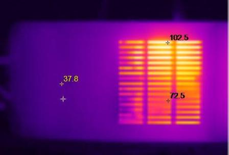

    i took this image while doing a routine check at a customers premises note the temperature 102 degrees
Name:	2 ballasts in an enclosure.jpg
