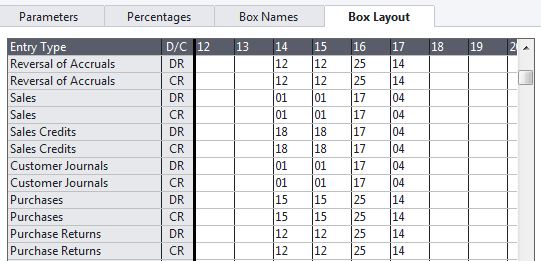

    thank you, this does help, are you able to also maybe send me a screen shot of the box layout specifically the purchases DB and Cr ?? if you wouldn't mind.

    And here are the box layouts:
ID:	7341   Click image for larger version.
ID:	7342   Click image for larger version.
