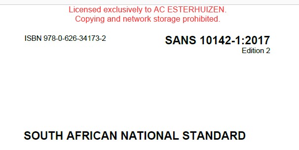

    I would like to start a thread specifically to discuss the new SANS 10142-1:2017 (Ed. 2.00)
    My first question is
    When I purchase the PDF version can I install it on my office computer as well as my phone?
    I could with the 2009 version
    Mar 2012
    Account_Deleted
    165
    122
    Thanked 23 Times in 18 Posts
    I would think so?
    But when in doubt: (last page in sans pdf)
    Copyright:
    The copyright in a South African National Standard or any other publication published by the SABS
    Standards Division vests in the SABS or, in the case of a South African National Standard based on
    an international standard, in the organization from which the SABS adopted the standard under
    licence or membership agreement. In the latter case, the SABS has the obligation to protect such
    copyright. Unless exemption has been granted, no extract may be reproduced, stored in a retrieval
    system or transmitted in any form or by any means without prior written permission from the SABS
    Standards Division. This does not preclude the free use, in the course of implementing the
    standard, of necessary details such as symbols, and size, type or grade designations. If these
    details are to be used for any purpose other than implementation, prior written permission must be
    obtained.
    Details and advice can be obtained from the Manager – Standards Sales and Information Services.
    Tel: +27 (0) 12 428 6883 Fax: +27 (0) 12 428 6928 E-mail: sales@sabs.co.za
