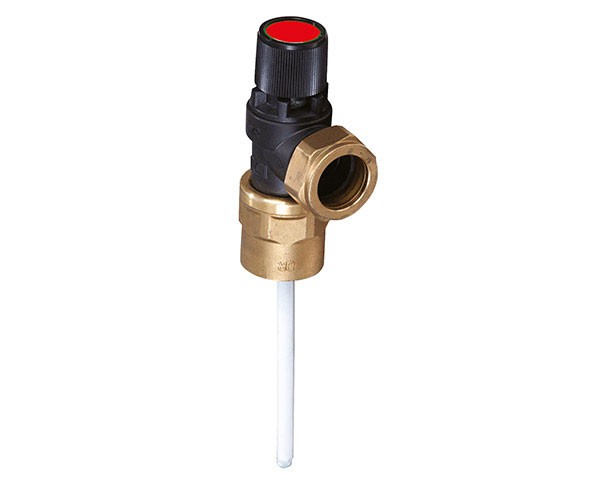

    Quote Originally Posted by Nucleo View Post
    ............and an electrician came and bypassed the municipal geyser /electricity setting.............
    I don't understand this part, can you explain exactly what the electrician did.
    It sounds like one of 3 things is happening.
    Either the thermostat isn't working or isn't set properly and it's cutting out much too soon.
    Or there's a power problem like a burned wiring connection causing the geyser to get intermittant supply
    Or there's a problem with hot water constantly flowing either through a tap, pipe leak or a TP valve leak. The TP valve leak is a good one because it usually flows through a pipe into a gutter where nobody can see it.
    TP valve; Click image for larger version.
