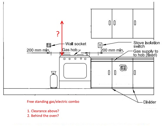

    Thank you, in light of this I will now insist that gas/electric combinations be connected by cooker plug or wired directly to the isolator(I have yet to see this)
    Please confirm the height above a gas hob which may not have electrical equipment.
    Is this applicable to free standing units as well?(self contained on its own feet, not in a cupboard)

    @Sparks, kindly print the PAINT file to a PDF as I cannot open it on my Mac

    Sparks image as Pdf and jpeg versions;
    Free standing gaselectric combo.pdf
Name:	Free standing gaselectric combo.jpg

    @Sparks,
    I trust the following assists you.
    With a stand alone appliance and container, there is a minimum distance of 300mm required between your stove and cylinder. Refer to paragraph 5.2.2.5 and Figure 1 below.
    5.2.2.5 Containers shall be located at least 300 mm away from a gas stove (see figure 1) unless
    the container is protected from the heat of the stove in an approved manner
Name:	min distance - container to appliance.jpg
    With regards to the distance behind the appliance, it must be at least 50 mm as per paragraph 6.2.5 below. Having said that please take note of the requirements of paragraphs 6.2.8 and 6.2.9. I think these paragraph also answer your question regarding the vertical space above a hob (even if free standing). Basically you need to determine the distance above the hob where the material used will not reach a temperature of 150C where all the burners are burning at full gas flow with no utensils placed on such burners. In general a distance of 1900mm from FFL is the minimum practical as any normal person does not want to bump their head against something when cooking.

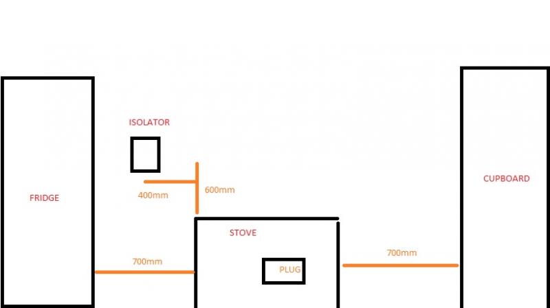

    Hi every one.
    I just came across this thread, and would like your input, regarding the installation of my Stove. The Stove is also an Electric Oven with Gas for cooking.
    My plan is to install the oven free standing with my gas bottles on the outside of the building and the stove plug is situated directly behind the stove.
    I have include a jpeg of the layout, including a few dimensions.
    On the left of the stove is a fridge and on the right of the stove is a grocery cupboard. Both are approximately 700mm form the stove.
    The isolator is situated 400 (y) by 600 (x) away from the stove.
    Do you think I have left enough of a gap between everything?

    From the answers received to my query you are good to go.

    Quote Originally Posted by montronic View Post
    ... and the stove plug is situated directly behind the stove.
    I'd suggest it's placed above the level of the hob and at least 200mm off to the side.
