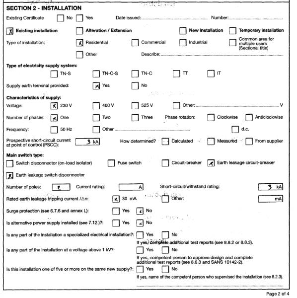

    I still have no idea how it could go "lost" surely earthing is a permanently fixed cable which needs to go to the DB board? I'm not an electrician so please excuse my ignorance. Nonetheless, I have also pasted the contents of the report HERE so you can have a look. The inspecting electrician did indeed not even pick that up either, I also do not recall providing the issued CoC to the second electrician so the likelihood is that he could have missed this plausible.
    What earthing arrangement was the installation stated as having on the CoC?
    No explicit earthing arrangement was even marked on the CoC, See screenshot 1 for reference.

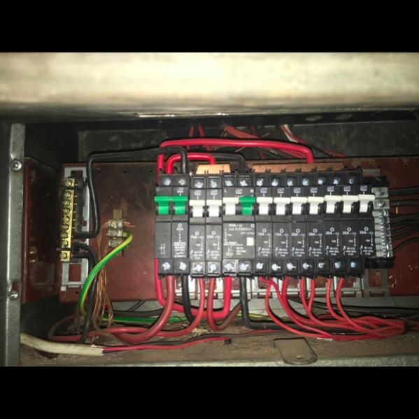

    Some pics of my DB board, if this helps?

    On that COC section 2 you've posted - it's incomplete (and that's putting it mildly).
    I'm also highly suspicious of the PSCC reading supplied. Either the issuer doesn't know what they're doing or they don't have the correct equipment to carry out the test. (Or both).

    That CoC in the screenshot is appalling, at a glance there's at least 8 omissions on that page. Whoever issued it was half hearted to say the least so I'd also take any info given with a large pinch of salt.
    I'm also a bit confused looking at the third photo, it looks like it might be a TN S supply that's simply not got the earth connected but it's a bit difficult to tell from the photo. Also not sure what that blue MOV looking device is there for either, I hope that's not someone's idea of lightning protection......

    The COC is unacceptable. I would assume that the PSCC is the fault rating that has been taken from the switchgear rather than a calculated or measured reading of the installation. The main switch is a disconnector and not earth leakage disconnector as stated on the COC. It would also appear that the incoming mains is connected to the load side of the isolator. I am not sure whether CBI allows this on their switchgear but if they do I assume there is no labelling to this effect on the DB.
