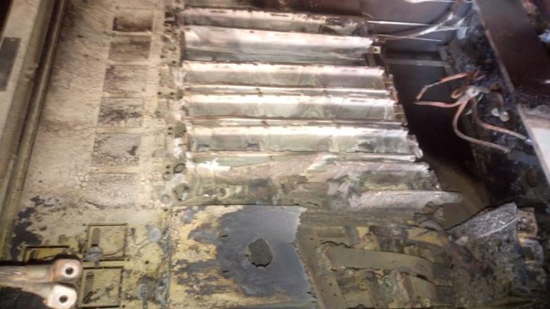

    And it gets better!
    Fuse that was 'hardwired' by contractor on Monday burnt the fuse board down on Monday night.
Name:	2018-08-07 09.38.12 (Small).jpg
    The hard wired fuse that cause the burn was the middle on the LHS
Name:	2018-08-07 09.37.01 (Small).jpg
Name:	2018-08-07 09.36.15 (Small).jpg
    Contractor was dispatched with large generator yesterday. Power was restored but I am still getting relatively low voltage, meaning overloading of conductors still exists (?)
    I'll refrain from rants of diabolical dysfunctionality and gross incompentence for now.

    Now the insane thing is the same frigging thing happened in the same sub station two weeks ago, only it was CP personnel who hardwired the fuses that time, that I witnessed and who ignore my cautionary advice, in fact ignored me, and would not answer my queries.
    Issue was reported to Area Manager Mr Mnisi who has yet to reply to me.
