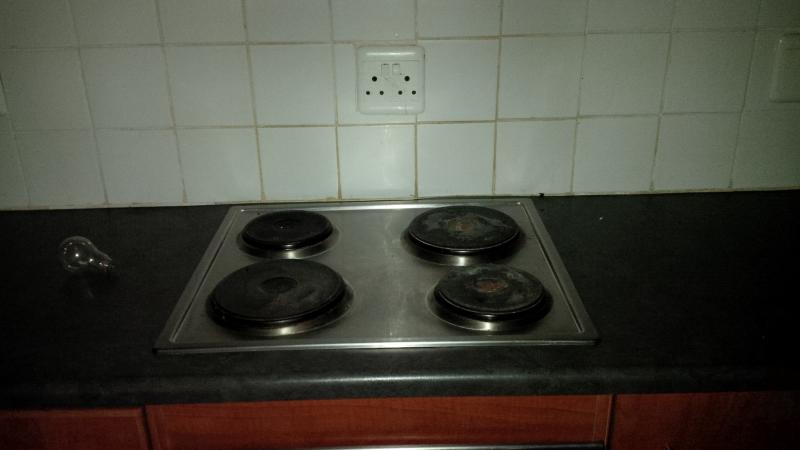

    This is the socket-outlet. Thanks guys. I'll disconnect it.

    If the (cbi or any other non-metallic) IP44 socket outlet (electrical equipment) is mounted (positioned) so that:
    5.1.2 Temperature
    5.1.2.1 Unless otherwise permitted by an applicable standard (see 4.3
    and table 4.2), electrical equipment shall be so designed, positioned and
    protected that accessible parts under normal operating conditions do not
    reach a temperature (safe touch temperature) that exceeds
    a) 70C in the case of metallic parts, and
    b) 90C in the case of non-metallic parts.
    So, if the stove plate are on, with a pot standing on the plate cooking something, (normal operating condition) the non-metallic socket outlet must not exceed a temperature of 90 deg Cel. That you can measure with Infra Red Thermometer. Metal socket outlets not more than 70C. If the plate is directly under the plug i will almost guarantee you that the plastic cover will reach more than 90C and melt (eventually). But you have to measure it to be sure. You must have the Degree Celsius.
    So me personally, I will not sign a CoC in that case, (if the temps exceeds the regulations) I will remove the electrical equipment from that position. But, if the temps stays within the limits according to regulation, and there is no other regs issues, i will sign it gladly.
    ps. The normal CBI pvc plastic plugs are all IP44.

    Yeah, I've seen a few in the past that are a debatable for environmental reasons but the one in the photo would fall fair and square in the unsafe category in my opinion. Temperature of the actual socket aside, any appliance plugged into it would leave a trailing cable in contact with one of the hob elements or extremely close. I'd remove/relocate that one.

    Not a very bright place to install a socket outlet in the first place. Maybe the stove was installed afterwards, but still. I will also relocate the sockey outlet to a more safe location.

    I would also definitely disconnect it and install a blank coverplate. If it is last in line I would remove the wiring to prevent re-connection!!
