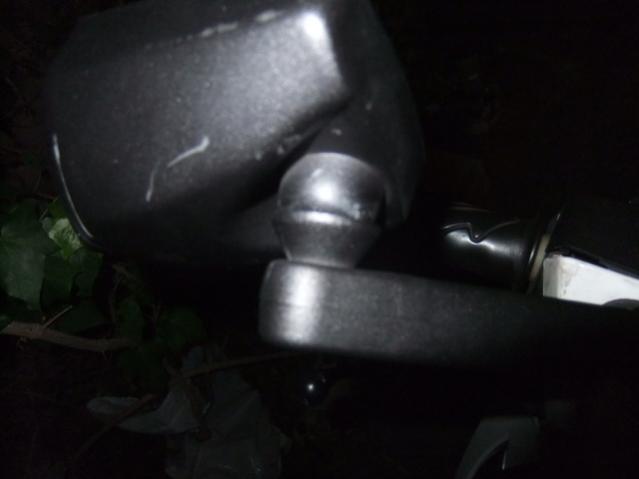

    Here is a picture too

    Drill 4 holes in the socket while attached, the wholes must go right through into the ball. Force silicone into the wholes. The shavings created from the drilling in the narrow space between the socket and the ball, with the silicone, should create enough friction to make it stiff-adjustable

    Try to carefully pull the glass of the mirror out and you'll probably find there's a nut or retaining screw inside behind the glass. Important things to remember; 1. If you lever the glass use something plastic, not a screwdriver. 2. No matter how hard you rub shit doesn't shine. If the mirror is cheap and nasty and poorly designed it"s doubtful it will ever work properly whatever you do to it.
