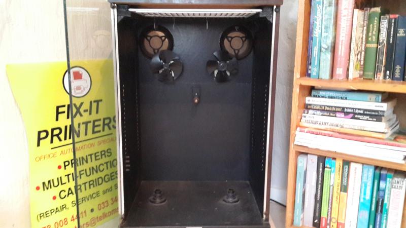

This is my biltong machine I made some years back which stands in my office. When I receive clients I often give them a piece, it makes them happy.

I bought an old Akai hi fi/record player at a second hand store and removed the units. I cut out two vents at the back, covering the wholes with car speaker covers. I installed 2 microwave vans and two light connectors at the bottom. I also installed a small light just below the vans. I made a rack at the top that slides in and out so you can hang the biltong. The whole inside is painted black, double coat. I have a whole array of switches at the back of the machine which switch on and off each individual electrical component. I even have a sensor on the door that switches off the vans when you open it. The small light just below the vans can be set to come on when the door opens or I can set it to stay on.
I mostly use the light fittings at the bottom when I make biltong in the summer to control humidity, and/or speed up the drying process.
With my machine I make big pieces, thin chilly bites, dry wors and even dried fruit. The machine dries the biltong quickly, but you can set it on one van with the lights off if you prefer to dry it over a longer period. I am getting hungry writing this.
