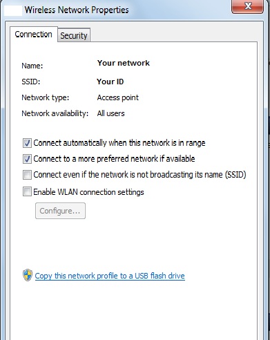

    If you access the wifi network properties, select auto connect, as in the image
