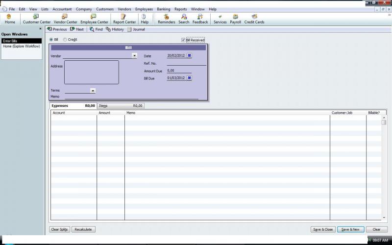

    Hi Dave i have attached what the bill looks like i dont see anything that allows me to select inclusive or exclusive Vat. I use this all the time to capture bills, expenses, etc.

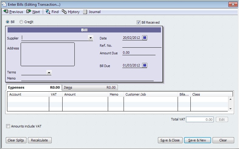

    Upon closer examination, it looks like whomever set up the software has tried to eliminate anyone playing with VAT the way the software intended.
    Is the VAT option enabled?
    What troubles me is my bill form includes a selectable VAT column. See attached.
    I was wondering if there might be version issues too, but ultimately I've had this setup since QB 2003, so I doubt that's it.
    If VAT is already enabled, you're probably going to have to modify the bill template.

    I think its probably a version issue....nowhere do i find VAT....
Name:	QB PREFERENCES.jpg
    urgh

    Damn straight it's a version issue. Probably the USA/Canada one, although there are also derivatives for Australia and Asia which use GST rather than VAT.
    If you're going to continue using that version, it's going to take a bit of a work-around when capturing expenses with input VAT. Obviously you can use the GST functionality to deal with Output VAT.
    If you create a main ledger account (other asset or liability) to track VAT inputs, you can post the Input Vat portion of the bills there. It means capturing two lines for each bill/expense - the VAT portion and the expensed portion.
