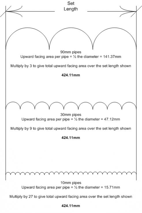

    If you're using set diameter coils then the surface area would be similar regardless of pipe diameter (see examples below). I agree you want a decent flow rate but it might be worth considering asheet of glass or perspex or even some clear building sheeting over the coils to reduce heat losses to the surrounding air.
