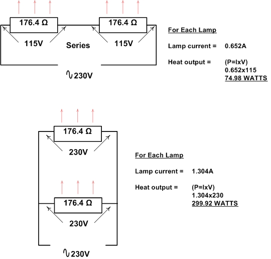

      Will the series wiring also halve the power consumed?
      I am thinking 2 x 150 watt lamps wired individually or in parallel will total 300 watts, using 1.25 amps (300 watts = 1.25 amps x 240 volts)
      What part of the above equation will change by putting the lamps in series, the watts or the amps, since the volts are a constant?
        The wattage stated on the lamp is not a 'given', it's dependant on the lamp being supplied the voltage it's rated at so you can't use the wattage as a base point for any calculations. If you wire 2 lamps in series you're supplying them with half their rated voltage which means the power (wattage) stated on the box no longer applies.
        The lamp is 300 watts at 230v it has a resistance of 176.4 ohms. This resistance is the constant you'd use in any calculations.

          The filaments will also be operating at a lower temperature, which may reduce the resistance a bit and may also affect the frequency of the radiation emitted.

            Thanks guys, that makes sense now.
            I used to know some of this stuff, but time has not been good to the memory cells.
            Series will give me my desired results in terms of heat output and power consumption. Hopefully the globes may last a little longer too, as they will be running cooler.
