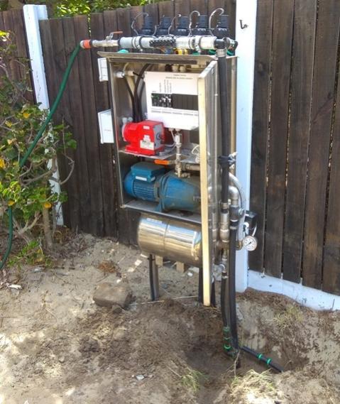

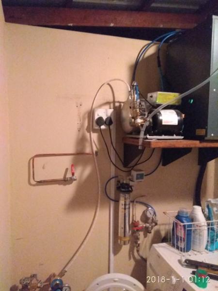

    Existing wellpoint pump;

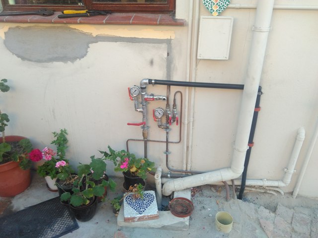

    Check valve, strainer, filter, PRV and pressure tanks;

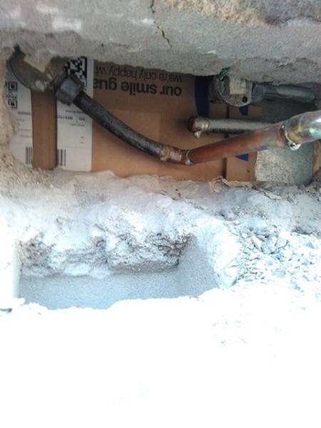

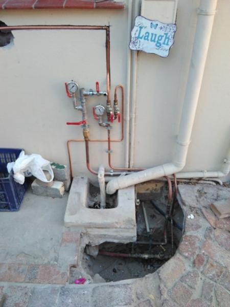

      Digging up council main and installing take-off pipe, check valves, tap and wellpoint supply pipe.

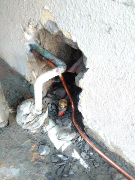

      Installing new pipework for kitchen sink cold tap, soda machine, coffee machine etc;

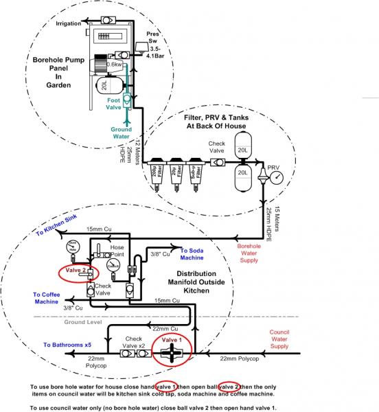

        This was the schematic drawing I was working to. There's a couple of minor inaccuracies where the plan changed slightly and I haven't ammended the drawing but it's pretty close for the most part. You should be able to match up what you see in the photos above (pipes, valves etc) to what's on the drawing.

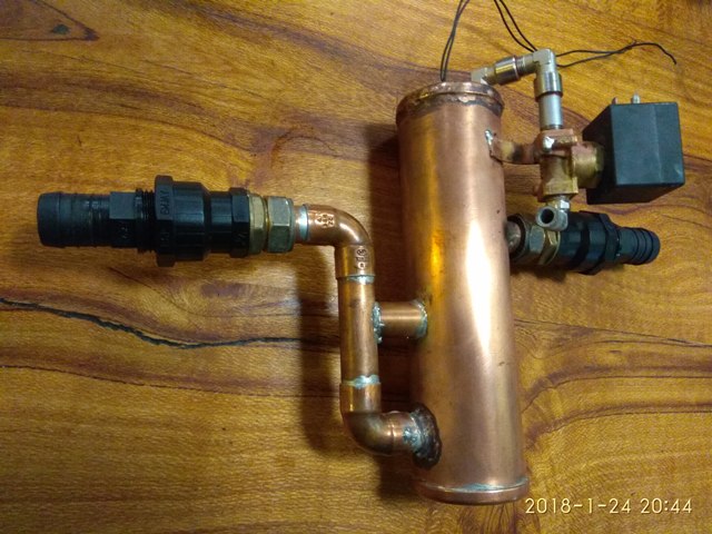

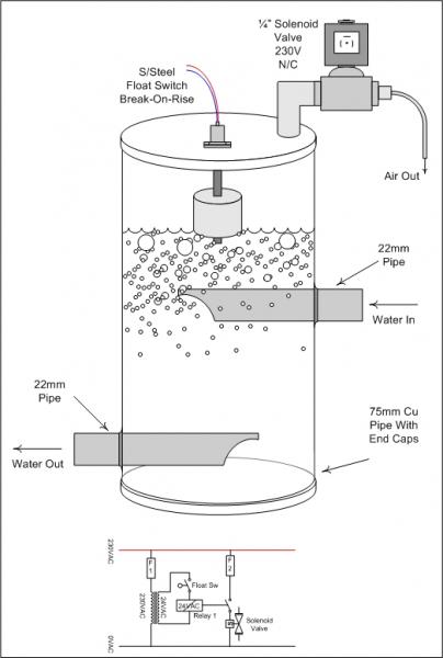

                I've been running on well point water for nearly a month now and so far so good apart from one minor hic-up; the wellpoint has a quantity of air in the water. In the past it just used to make the irrigation sprinklers intermittantly hiss and it never bothered us but the air seems to build up in the geyser especially and causes the hot water in the showers to spit quite violently every couple of minutes which was somerthing of an annoyance.

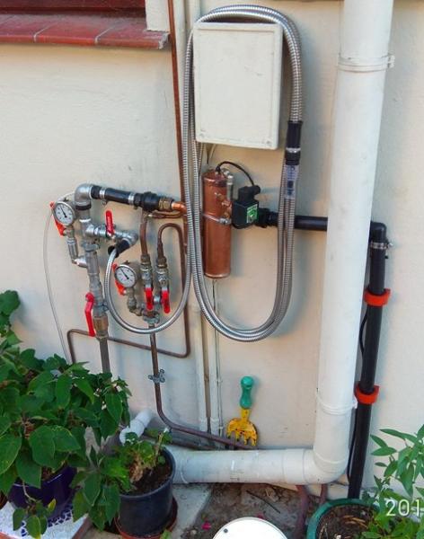

                I decided to make an air separator from junk I had in the workshop so I managed to dig out an off-cut of copper drain pipe and a second hand solenoid valve that was from a scrap coffee machine and this was the result;
                The only new parts were a stainless steel float switch which I had in stock and the pipe fittings.
                  I installed it today and it works pretty well up to flow rates of about 13 litres per minute. Between 13 and 20 litres per minute it discharges progressively more water every time it dumps the air that's collected. Anything much above 20 litres per minute flow rate there's air carrying through it.
                  The diameter of the separator is the limiting factor, ideally it should have been 100mm diameter but the only off-cut I had on hand was 67mm so the velocity of the water going through it gets too high. I didn't have any other suitable pipe available and I didn't want to shell out the cash for a full 6 meter length when I was only going to use about 40cm of it so if anyone in Cape Town has half a meter of 100mm copper or stainless pipe with two end caps kicking around, let me know what you want for it or I'll trade you for it.

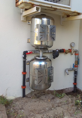

                  Here's the separator installed;
                  And this was the concept sketch I was loosely working to. There are numerous discrepancies between the sketch below and the finished prototype shown above and I haven't bothered amending it because I'm sure anyone who wants to build one will improve and adapt it to their requirements.

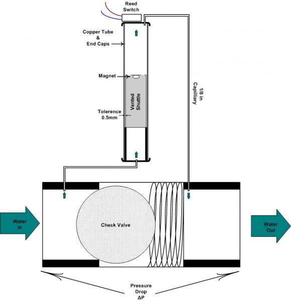

                    I installed the UV sterilizer and the drinking water filter this weekend. The UV-C tube in the sterilizer has a life rated at 8000 hours which is only about 10 months if it runs continuous so I want to install controls so it only operates when there's water flow.
                    I need a flow switch that can give me a signal for water flow between 0.2 and and 25 l/min. I'm struggling to find something suitable that doesn't cost a fortune.
                    I thought I'd give it a bash with fabricating my own and I've been mulling over a few ideas but I'm not sure the best way to go about it. I thought I might use a standard brass check valve to give me a small pressure drop and use that to cause water flow in an auxilliary circuit to cause a shuttle in a sleeve to raise against gravity. If the shuttle has a small magnet on the top it could operate a reed switch mounted externally if all the components and non-magnetic.
                    I'm not sure if this is the best way, there's a lot of variables involved and I've got a suspicion it could get a bit messy with the tolerances and the tweaking involved to get it to work. Anyway, I did a sketch which is below, if you've got any advice or even any better ideas on a completely different track please let me know.
Name:	Flow Switch.jpg
                      Hi Andy,
                      Maybe use a flow meter from Mantech. A little bit of electronics, such as a small transistor connected to the output pulse train, charging a small value cap would switch a relay on, enabling the UV circuit.
                      Very simple and cheap. Simply place a diode in series with the output pulse train, charging a 1uF capacitor, in turn connected to the base of a transistor like a BC337, and the emmiter to 0V supply, and the collector to the one side of the coil, and the other side of the coil connected to 12V supply. When the flow meter runs, the pulses would charge the capacitor up, and switching the transistor on, which in turn will switch the relay on. When the water stops flowing, the capacitor would discharge through the base of the transistor, switching the transistor off, and in turn switching the relay off.
                        That hall effect sensor looks promising, I'm going to pick one up to play with.
