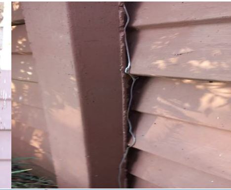

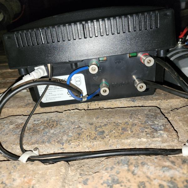

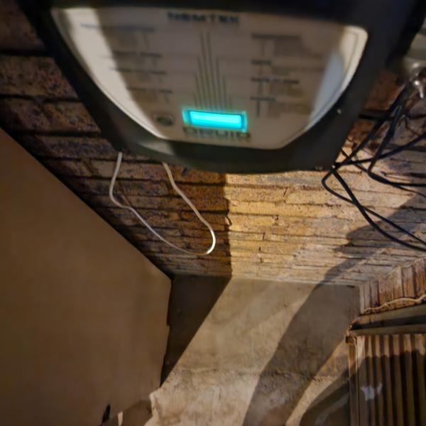

Below are pics showing top and bottom view of energizer, as well as the typical type of cable used in the fence earthing.
Where in some places is has detached, and in all other places there is no conduit protecting such a cable. ( I understand this to be a requirement)
Please advise!!!!
