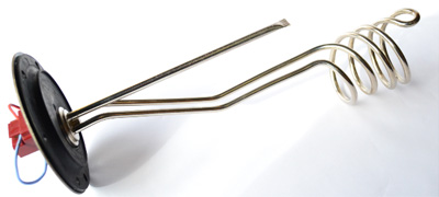

                            After a quick Google it appears Northface already have it for sale on their website;
                            Econocoil - efficient water heating
                            [ATTACH=CONFIG]6587[/ATTACH]
                            Save 20-40% of your water heating bill simply by changing to this element. Applies only to Kwikot 150l horizontal geysers.
                            Read more
                            The Econocoil minimises the heat losses and maximises the heating efficiency of the geyser. It does this by moving the heated part of the element further from the edge of the geyser and using convection to move the hot water to the more insulated part of the geyser.
                            3 month money back satisfaction guarantee
                            12 month warranty (extendable to 24 or 36 months)
                            The perfect time to install Econocoil is when your standard element breaks and needs replacing.
                            This is a product that allows people who cannot afford R15,000 or more for a solar system, to at least make a real dent in their heating expenses.
                            A couple of things confusing me here, firstly the claimed savings on the website go as high as 40%. Secondly the way it's claimed it saves energy is by moving the heated part of the element further from the edge of the geyser and using convection to move the hot water to the more insulated part of the geyser
                            So, by the element being a different shape it's possible to reduce electrical consumption by 40%...??? Bold claims indeed, call me a sceptic but I'd like to see the proof.
