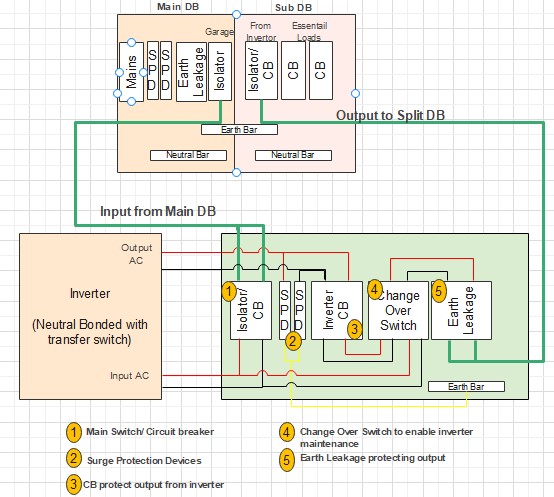

I have a Skyking inverter that I want to permanently wire as part of my house's electrical installation.
I tried my best to come up with a wiring diagram of how I see it (very much based on previous threads).
I am especially worried about the placement of the earth leakage (especially SANS regulations) and would appreciate your advise.
Apologies for my take on a wiring diagram.
