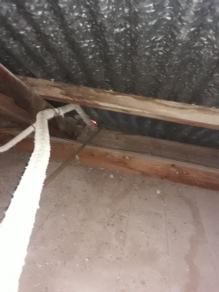

              Hi All
              Called out on Thursday for tenants shocking on taps.
              We knew before we went to sight that the neutral was gone.
              Sure enough. No Neutral.
              While we were on sight the client asked if I knew a plumber, as there was a water leak.
              I got up in the attic and found what had caused the leak.
              Arcing between the hot water system and the tin roof. The pipe had arced through and was leaking.
              Just shows how quickly a house can catch alight if the neutral decides to get stolen.
              The photo is not as clear as daylight, but I'm sure you get the idea.
              This photo was taken with the main switch turned off. Scary.
