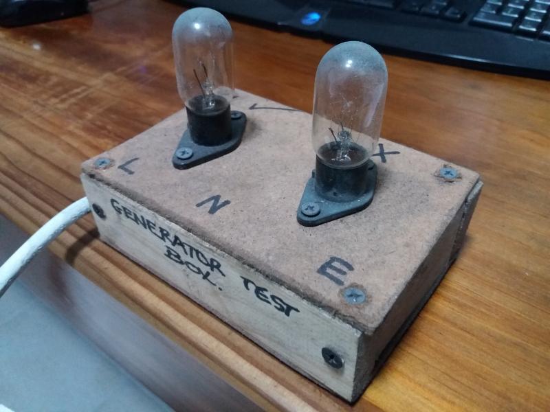

                It is advisable to take voltage measurements on any genny with a light load connected to check if it's VOV or not.
                Many gennies that are not vov will still give strange voltage readings if measured on no load. This is due to the high impedance of most multimeters.
                Incandescent lamps work well and I use my test box as in photo attached. Plug it in and if both lamps light up, it's VOV for sure. If only the left side lamp lights up, you good to go.
                You are correct that you cannot be held responsible for anything plugged in by the client after you leave site, however, it's a good idea to first check the genny that the client intends connecting BEFORE doing the installation. If I find it's a VOV, I explain to the client why I will not be doing the installation and also show them the relevant regulation.
                I usually plug in my test box in front of the client and they do understand that it's in their own interest not to just plug in anything. On many occasion I have had clients requesting that I accompany them to the genny sales house to make sure that the genny they are purchasing is suitable for purpose.
                Peace out, Brother.

                  thank you sir. it was all i asked.
                  i will build your 2 light system, but smaller. with a reasonable load.
