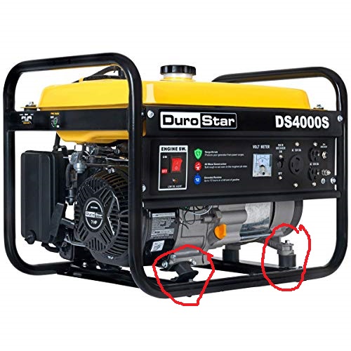

                  I am talking about a portable generator, not a standby one that's connected to the installation.
                  I'm thinking now, how many people have been shocked while using an appliance plugged into a portable genny ?
                  Derek.
                  One of the reasons for VOV gensets on site .
                  The voltage to earth if you pick up a shock is 110v not 220v
                  A genset is generally not referenced to earth , rubber vibration pads between genset and frame - If you measure from live to ground as in earth , sand , you should measure 0V , so you cannot become the earth path

                    You must like in the Cape ... I have never in all the time of hiring purchasing or installing a 5 kva generator ever seen a generator with vibrating pads ... other than the bigger diesel floor standing units ... we install vibration pads.
                                The alternator and petrol motor are normally fastened to the frame of a portable set with a rubber vibration pad as per attached pic
