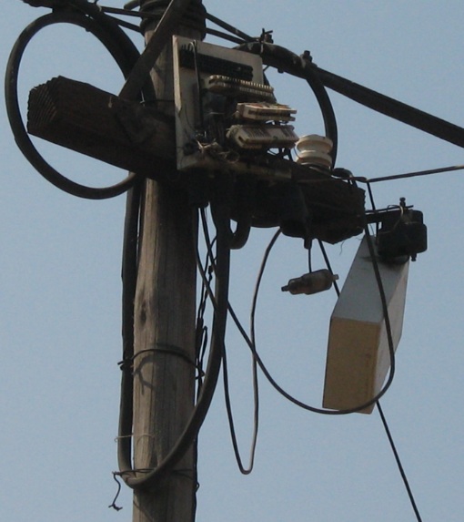

        They say a picture is worth a thousand words, Well I think my Telkom problem must be seen...
        Now please note it has been like this since January this year...
        Telkom just don't give a damn
        and no it is not a fake photo...
        steps I took,
        • Fist step: Log a fault...
        • Second step: Follow-up every weekday for 1 month
        • Third step: Follow-up once a week for 1 month
        • fourth Step: Give up after 5 months...
          Errr! get a fax to email account!!! there are ones you can send via email as well, speak to Nigel Hamilton
            If you are on ADSL, you still need a Telkom line.
            With the terminals exposed like that, when ever it rains, you get this constant crackling on the line, which also affects the ADSL upload due to errors in the data.
              My line is "dodgy" I sometimes wonder if Telkom is not making a point that they actually don’t want my business/money anymore? and is hoping I would leave them?
              Sad thing is I do pay line rental for that mess it is sickening….
              Sometimes the phone will just ring and ring and no one is calling... Or intermittent problems where the line just goes dead and then it comes back on again.
