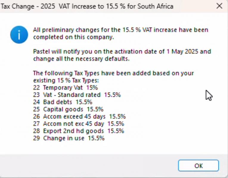

    Select either the Partner or Xpress link, depending on what you are using. Once downloaded, make a backup of your company, then close Pastel on all machines, and install the new Build. When you open your company for the first time, you will be prompted to rebuild your data files. Once that has been completed, you will see the following message appear:
Name:	VAT Notice 2025-04-14 05_27_31.jpg
    Click on OK. That’s all you need to do. When you open your company on 1 May 2025, you will get a notification that all your VAT settings will be changed to the new rate, where applicable.

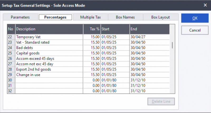

    • Insert the following new lines:
Name:	New VAT rates 2025-04-14 05_37_29.jpg
