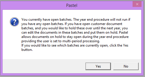

    I have been struggling with my pastel year-end roll over... When I follow the procedure to change year-end, Pastel requests to close/delete outstanding batches BUT I cannot delete any batches...as displayed in the image below:

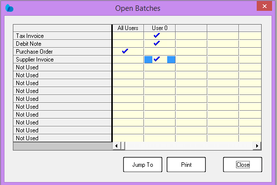

    So as requested to open the batch viewer to see open batches, as shown in the image below:
    So the problem arises when I select the batches from the second image and want to delete it this is the issue it gives me...

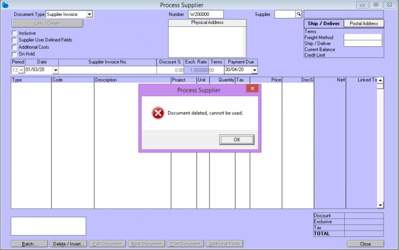

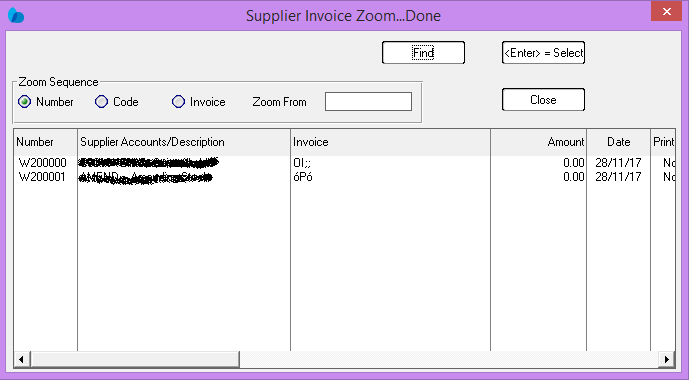

      Every time it requests to remove or delete the batches. I goto a specific batch such as supplier invoices. When it prompts me with current supplier documents that are "outstanding" I select them as such:
      I select one of those two documents and it prompts me with "Document deleted, cannot be used". So how can one remove these batches that pastel is requesting it to be removed when you cant select the document and its telling me that its already deleted although pastel is complaining that its still an open batch....

        Hi Alexander - from the look of that attachment you have some file corruption. Have you run the "file / data integrity" option yet?
        If there are some corrupted files then Neville Bailey is the person to contact as he has the software to get into the data and may be able to help you. He is a member of this forum and you can send him a private message should you need him.
        • Neville Bailey
          • 2786
          Only just saw this thread, sorry.
          Even though the batches contain deleted documents, you still need to update the batch, by clicking on the Batch button at the bottom left of the screen, and then click on Update.
          Purchase Orders do not need to be updated.
