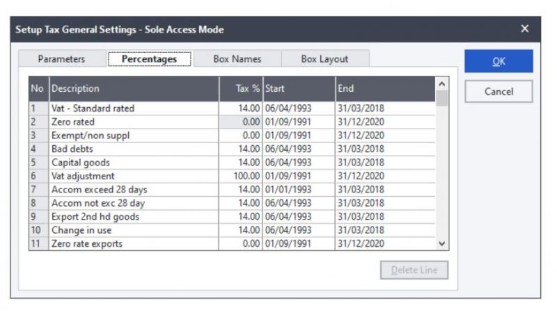

    The Customs duty tax of 100% VAT is usually under TaxType 6. You can see it under Setup > Tax > General Settings > Percentages tab. See below:
Name:	Tax type 6.jpg

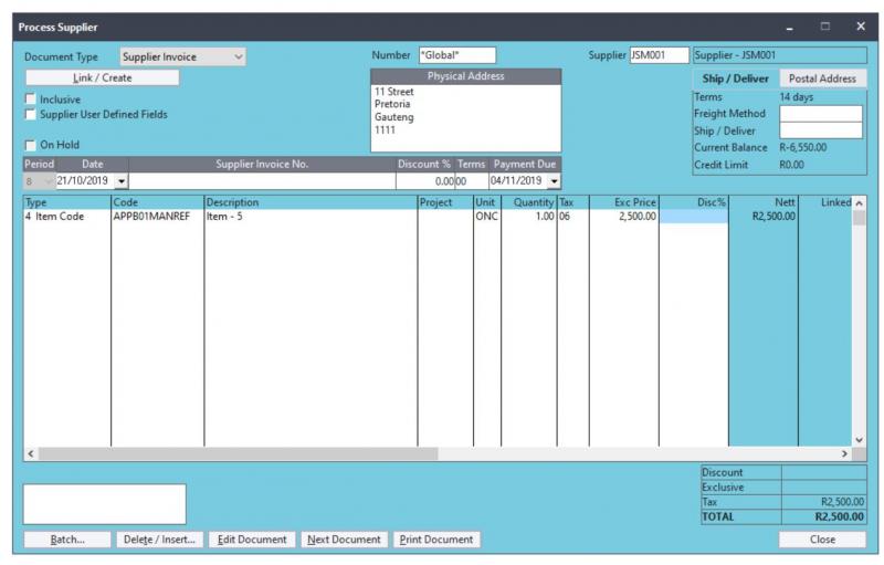

    Using this code under any Item code (SearchType 4) will result in 100% of the amount being allocated to VAT. See below:
Name:	Supplier invoice • 6 Tax type.jpg
