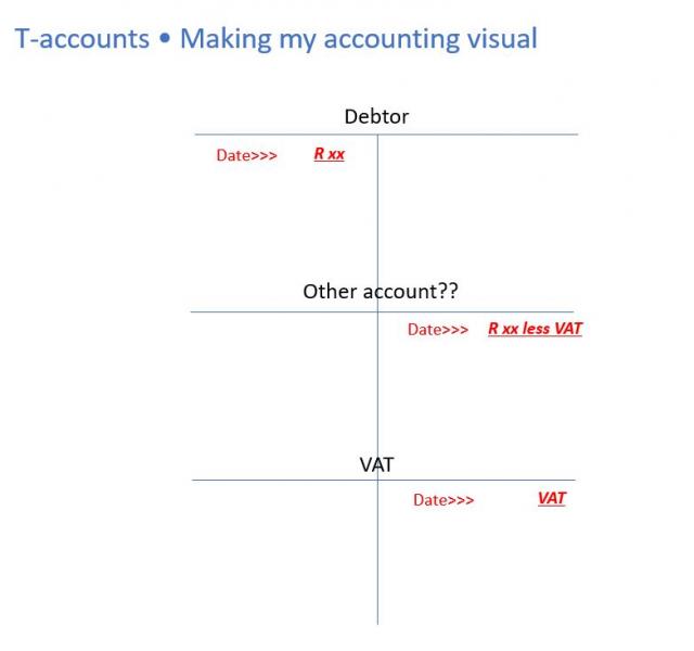

      Hi Neviron
      Take-on balances is a very technical subject, so I am glad you have brought it to this forum. I have seen many people rush it, just to sit with an eye-sore in their books forever.
      I agree with Neville's feedback. I do want to strongly advise you to draw out your T-accounts on a piece of paper.
      Your one leg is a customer account, but you say you do not want to affect the income statement on the other leg. What account do you want to affect on the other leg? Your T-accounts will visualise what you would like to achieve as an end result. I have started drawing out the journal you have explained below to show you how you can visualise it. Once you have populated the "Other account??", the "Date >>>" and the Values you can have a much better next step idea.
Name:	T-accounts • Make your accounting visual • 2.jpg
      Hope this helps.
      Looking forward to hearing from you.
