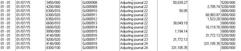

        Ok, just checking ... does this look correct?
