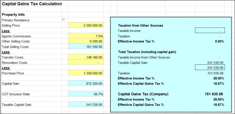

                            Thank Clive I really appreciate the input...I've been working off I template I found online, do you mind if we do this again?
                            Firstly this property is brand new and is not earning any rental income (vacant), so there is no extra income.
                            Based on the screen shot below I have this calculation:
                            R2 500 000 (gross sales price) - R181 500(agent comm) - R148 196 (transfer costs) - R151 630.08 (CGT)
                            = R2 018 673.92 net profit
                            if we declare this as a dividend we get R2 018 673.92*15%= R302 801.088 subtract from R2 018 673.92 =1 715 872.83 paid out to sharholders.

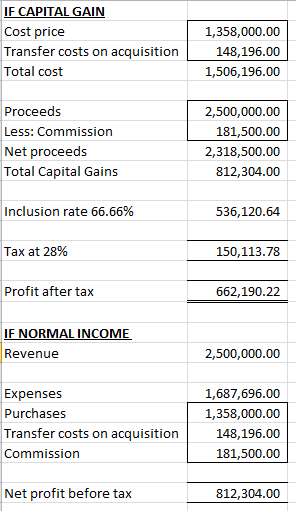

                              which means that you will most likely fail in your attempt to have it regarded as capital profits and will instead be regarded as normal profits.
                              I'll try to illustrate both scenarios:
Name:	CAP VS REV.png
                              I assume the company got the money from you to acquire the property? If that is the case then it would be unnecessary to declare a full dividend; it would first repay the loan it made from you.
